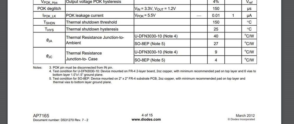

Our designers use the thermal coefficient from the datasheet as the reference (example below), so requirement would be that the connection be similar to what the manufacturer used for the specification. However, it is unknown the standard that the manufacturer is using for installation of the device.
