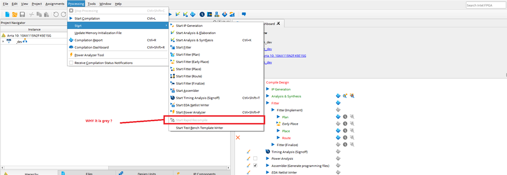

Why Arria10 doesn't support "incremental compiling" in Quartus Pro 19.2
Hello expert,
I have a Arria10 Project, and it needs 2+ hours to compile it completely. The project debugging is very very slow , becasue we need to wait the project compiling completiob each time when we modify a bit code for further debugging.
In Quartus Pro menu list, I found that "rapid compile" is grey, so I just wonder How can I enable "rapid compimling" to quicken the project compiling, to ease the debugging. Is there any method to enable "the incremental compiling" in my Arria10 Project ? Thanks

    Can you upgrade to latest release 20.2? If no, you will have to use command line to run the rapid recompile.
    Put this to test.tcl and run it with quartus_sh -t test.tcl
    load_package design
    load_package flow
    project_open Test
    execute_flow -compile
    #execute_flow -recompile
    #execute_module -tool fit
    #execute_module -tool sta
    project_close

    Rapid recompile is should be supported in Arria 10 device. May I know which version that you were using? I tested it in Q20.2pro edition and it is working. Also, you need to turn on enable intermediate fitter snapshots to use this feature.
    To reduce the compilation time, you can refer to https://www.intel.com/content/www/us/en/programmable/documentation/zpr1513988353912.html#mwh1410471192919 -> 2. Reducing Compilation Time
    If you were using signal probe for debugging, you can refer to https://www.intel.com/content/www/us/en/programmable/documentation/cxt1478215337364.html

      Hi @KennyTan_Altera , I use "Quartus Prime Pro 18.1" .
