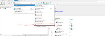

Why Arria10 doesn't support "incremental compiling" in Quartus Pro 19.2
- 6 years ago
We are doing some migration work, so the subscription might not ready. I will check internally.
Can you upgrade to latest release 20.2? If no, you will have to use command line to run the rapid recompile.
Put this to test.tcl and run it with quartus_sh -t test.tcl
load_package design
load_package flow
project_open Test
execute_flow -compile
#execute_flow -recompile
#execute_module -tool fit
#execute_module -tool sta
project_close
