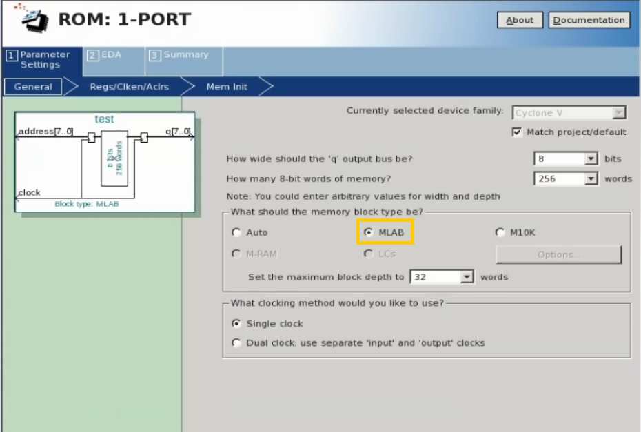

    May I know what device you are using? It would be great if you could provide the QAR archive file as it contains all the settings same as your design file. To generate the archive file, click on Project > Archive Project
    KhaiY
  • KhaiChein_Y_Intel's avatar
    KhaiChein_Y_Intel
    I can duplicate the error, the ROM type is set to AUTO even the romstyle="MLAB" attribute is used. I tried to set the romstyle to "M10K", the ROM type is set to M10K in the Fitter report under RAM Summary, which is the correct behavior. I think this is the error on MLAB setting only. I will file a case to engineering for this error. Thanks for reporting this to us. Coud you use the IP Catalog to instantiate ROM with MLAB type as a temporary workaround?
    KhaiY
    KhaiChein_Y_Intel
    May I know if you are able to proceed with the temporary workaround?
