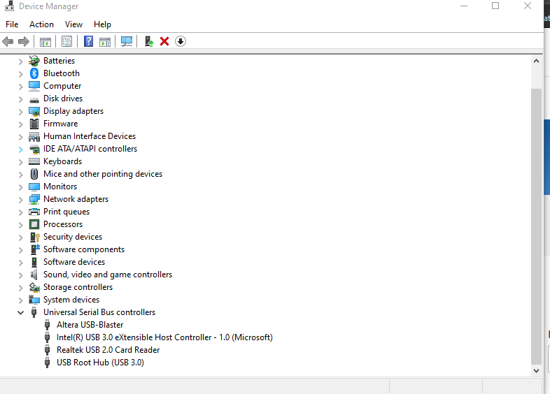

Hello everyone,
I have both quartus 11.1sp2 and quartus 15.0, and both can't find my altera boards (de0 nano and 5CG), the usb blaster drivers are installed and windows 10 can detect my boards as you can see in the picture i attached, what can i do to resolve this probleme.
P.s : I uninstalled and reinstalled the drivers but nothing happens, and did the same thing with quartus

    1. Potential Quartus USB blaster driver and OS compatibility issue
    • Based on your screen shot so far, USB blaster driver installation looks good
      • One thing to take note is Quartus version and OS compatibility issue. Win10 is not meant to be used with older Quartus version. You are using very old Quartus version which is developed using Win7 where Win10 may not exist at that time
