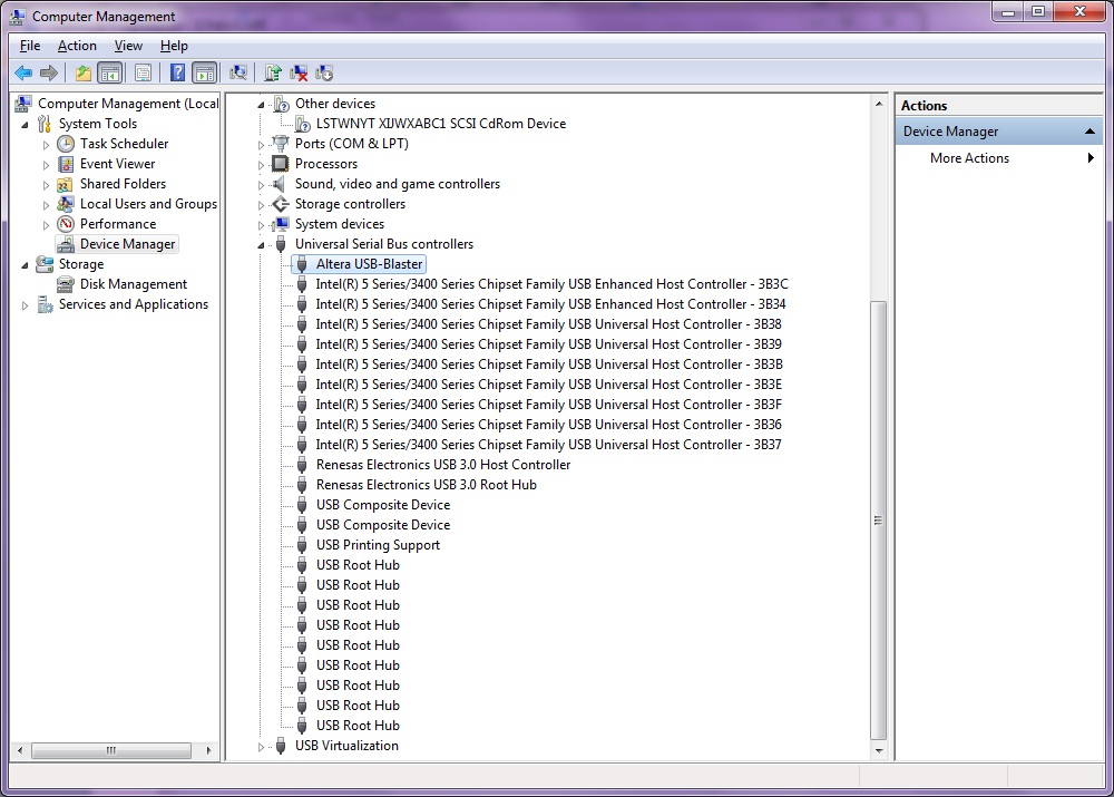

Does the USB device show in the Windows Device Manager? How?

For those who're having the same problem as I did, in the programmer, just go to: edit -> add device... And add in the device to be used. Fin. - Altera_Forum
Honored Contributor
This is more easy and applicable for those find it hard to run their altera de-2 board..and itz a conform working method
1. Unzip the usb-blaster.zip file provided to a convenient location (e.g., your desktop). This will create a usb-blaster folder. a. http://myweb.msoe.edu/durant/courses/ce1900/usb-blaster.zip 2. Connect USB Blaster to USB port on laptop (UP2 board does not need to be plugged in) 3. Receive unsuccessful installation message 4. Go to the Device Manager (can search from Start menu) 5. Right click on Unknown device under Other devices 6. Update driver software… 7. Browse my computer for driver software 8. Browse to the folder with the zip file contents. Do not go into a subdirectory (e.g., use usb-blaster, not x64) 9. Ok, Ok, Next 10. Warning message appears: “Windows can’t verify the publisher of this driver software” 11. Click “install this driver software anyway” 12. Receive success message that “Altera USB-Blaster” has been installed 13. Close Cheers Alen - Altera_Forum

--- Quote Start --- Well, I'm just not able to get the USB-Blaster to install on my XP machine... It's driving me crazy... The best I can get to is a screen that shows a code(10) error.http://www.running2win.com/images/usb-blaster.jpg (http://www.running2win.com/images/usb-blaster.jpg) Nothing seems to work. I tried the zip file and I get a message saying "The specified location does not contain information about your hardware." I really need to be able to work from home but I feel like I've tried everything. --- Quote End --- Well the method works for windows 7 only... For Windows XP, do the following: 1. Plug the USB-Blaster download cable into the PC. The Found New Hardware dialog box appears. 2. Select Locate and install driver software (recommended). 3. Select Don't search online. 4. When you are prompted to Insert the disc that came with your USB-Blaster, select I don’t have the disc. Show me other options. 5. Select Browse my computer for driver software (advanced) when you see the Windows couldn’t find driver software for your device. 6. Click Browse... and browse to the <Path to Quartus II installation>\drivers\usb-blaster directory. Click OK. 7. Select the Include subfolders option and click Next. 8. If you are prompted Windows can’t verify the publisher of this driver software, select Install this driver software anyway in the Window Security dialog box. 9. The installation begins. 10. When The software for this device has been successfully installed appears, click Close. If you are running Windows in 64-bit mode, you MUST boot your computer as following both when installing the USB-Blaster driver AND when using Quartus to program your PLD.  During boot up of the computer, continuously press F8 (but do NOT hold it down).  Scroll down to “Disable Driver Signature Enforcement,” then hit Enter. You must set up the driver before programming your PLD (CPLD or FPGA). - Altera_Forum
Honored Contributor
These instructions are not working. I use windows 7 and the driver installed no problem but the DE2 won't appear in Quartus Programmer. So there is some other error than driver installation, it's that Quartus Programmer can't recognize the card even though device manager can.
