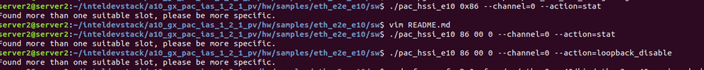

"Found more than one suitable slot" while testing the 10GBE PAC-PAC test
I am testing the PAC -to -PAC Ethernet MAC 10 Gbps link. When i program both the intel Arria 10 GX PAC cards with the same design and executing the host code i am getting the following output.

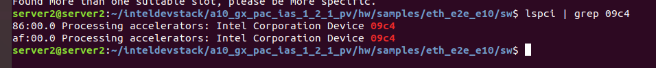

Could you try "lspci | grep 09c4" and provide me the information?
- nikhl
@JohnT_Intel ,Two devices are showing up on the lspci.

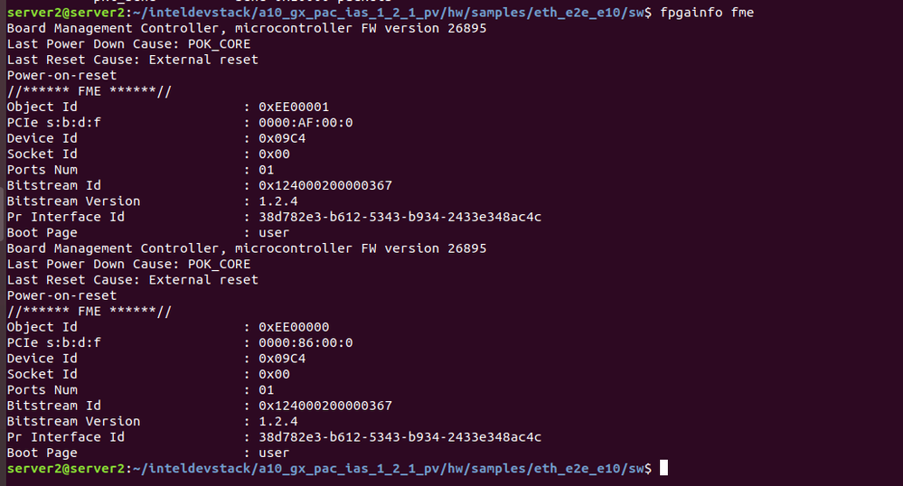

Can you try "./pac_hssi_e10 -b af -d 00 -f 00 --channel=0 --action=stat"? If you are still facing issue then can you try running "fpgainfo fme"?
- nikhl
When i try to run the "./pac_hssi_e10 -b af -d 00 -f 00 --channel=0 --action=stat" it is saying "invalid bus :AF" but on fpgainfo fme both the PAC cards are showing respectively with the bus number "AF" & "86".

server2@server2:~$ sudo fpgainfo fme Board Management Controller, microcontroller FW version 26895 Last Power Down Cause: POK_CORE Last Reset Cause: External reset Power-on-reset //****** FME ******// Object Id : 0xED00001 PCIe s:b:d:f : 0000:AF:00:0 Device Id : 0x09C4 Socket Id : 0x00 Ports Num : 01 Bitstream Id : 0x124000200000367 Bitstream Version : 1.2.4 Pr Interface Id : 38d782e3-b612-5343-b934-2433e348ac4c Boot Page : user Board Management Controller, microcontroller FW version 26895 Last Power Down Cause: POK_CORE Last Reset Cause: External reset Power-on-reset //****** FME ******// Object Id : 0xED00000 PCIe s:b:d:f : 0000:86:00:0 Device Id : 0x09C4 Socket Id : 0x00 Ports Num : 01 Bitstream Id : 0x124000200000367 Bitstream Version : 1.2.4 Pr Interface Id : 38d782e3-b612-5343-b934-2433e348ac4c Boot Page : user server2@server2:~$ cd $OPAE_PLATFORM_ROOT server2@server2:~/inteldevstack/a10_gx_pac_ias_1_2_1_pv$ sudo fpgaconf -B 0x86 hw/samples/eth_e2e_e10/bin/eth_e2e_e10_unsigned.gbs server2@server2:~/inteldevstack/a10_gx_pac_ias_1_2_1_pv$ cd $OPAE_PLATFORM_ROOT/hw/samples/eth_e2e_e10/sw server2@server2:~/inteldevstack/a10_gx_pac_ias_1_2_1_pv/hw/samples/eth_e2e_e10/sw$ sudo sh -c "echo 10 > /sys/class/fpga/intel-fpga-dev.0/intel-fpga-fme.0/intel-pac-hssi.0.auto/hssi_mgmt/config" server2@server2:~/inteldevstack/a10_gx_pac_ias_1_2_1_pv/hw/samples/eth_e2e_e10/sw$ sudo sh -c "echo 10 > /sys/class/fpga/intel-fpga-dev.0/intel-fpga-fme.0/intel-pac-hssi.0.auto/hssi_mgmt/config" server2@server2:~/inteldevstack/a10_gx_pac_ias_1_2_1_pv/hw/samples/eth_e2e_e10/sw$ sudo chmod 666 /dev/intel-fpga-port.0 server2@server2:~/inteldevstack/a10_gx_pac_ias_1_2_1_pv/hw/samples/eth_e2e_e10/sw$ export LD_LIBRARY_PATH=`pwd`:$LD_LIBRARY_PATH server2@server2:~/inteldevstack/a10_gx_pac_ias_1_2_1_pv/hw/samples/eth_e2e_e10/sw$ ./pac_hssi_e10 -b 86 -d 00 -f 00 --action=loopback_enable no suitable accelerators found server2@server2:~/inteldevstack/a10_gx_pac_ias_1_2_1_pv/hw/samples/eth_e2e_e10/sw$ ./pac_hssi_e10 86 00 00 --action=loopback_enable Enabled loopback on channel 0 server2@server2:~/inteldevstack/a10_gx_pac_ias_1_2_1_pv/hw/samples/eth_e2e_e10/sw$ ./pac_hssi_e10 86 00 00 --action=stat_clear Cleared TX stats on channel 0 Cleared RX stats on channel 0 server2@server2:~/inteldevstack/a10_gx_pac_ias_1_2_1_pv/hw/samples/eth_e2e_e10/sw$ ./pac_hssi_e10 86 00 00 --channel=0 --action=stat_clear Cleared TX stats on channel 0 Cleared RX stats on channel 0 server2@server2:~/inteldevstack/a10_gx_pac_ias_1_2_1_pv/hw/samples/eth_e2e_e10/sw$ ./pac_hssi_e10 86 00 00 --channel=0 --action=pkt_send Sent 0x10000 packets on channel 0 from src=[0:0:0:0:0:0] to dst=[0:0:0:0:0:0] server2@server2:~/inteldevstack/a10_gx_pac_ias_1_2_1_pv/hw/samples/eth_e2e_e10/sw$ ./pac_hssi_e10 86 00 00 --channel=0 --action=stat ---------------------------------------------------------------------------------------------------- CHANNEL STATISTICS ---------------------------------------------------------------------------------------------------- CHANNEL |LOOPBACK |FREQ LOCK |WORD LOCK |TYPE ---------------------------------------------------------------------------------------------------- 0 |1 |1 |1 |TX ---------------------------------------------------------------------------------------------------- OFFSET |NAME |VALUE |DESCRIPTION ---------------------------------------------------------------------------------------------------- 0x1c00 |tx_stats_clr |0 |Clear TX stats 0x1c02 |tx_stats_framesOK |0x10000 |Frames that are successfully transmitted 0x1c04 |tx_stats_framesErr |0 |Frames that are transmitted with error 0x1c06 |tx_stats_framesCRCErr |0 |TX frames with CRC error 0x1c08 |tx_stats_octetsOK |0x2e0000 |Data and padding octets that are successfully transmitted 0x1c0a |tx_stats_pauseMACCtrl |0 |Number of valid pause frames transmitted 0x1c0c |tx_stats_ifErrors |0 |Number of errored and invalid frames transmitted 0x1c0e |tx_stats_unicast FramesOK |0x10000 |Number of good unicast frames that are successfully transmitted 0x1c10 |tx_stats_unicast FramesErr |0 |Number of errored unicast frames transmitted 0x1c12 |tx_stats_multicast FramesOK |0 |Number of good multicast frames transmitted 0x1c14 |rx_stats_multicast FramesErr |0 |Number of errored multicast frames transmitted 0x1c16 |tx_stats_broadcast FramesOK |0 |Number of good broadcast frames transmitted 0x1c18 |tx_stats_broadcast FramesErr |0 |Number of errored broadcast frames transmitted 0x1c1a |tx_stats_etherStats Octets |0x400000 |Total number of octets transmitted 0x1c1c |rx_stats_etherStatsPkts |0x10000 |Total number of good, errored, and invalid frames transmitted 0x1c1e |tx_stats_etherStats UndersizePkts |0 |Number of undersized frames transmitted 0x1c20 |tx_stats_etherStats OversizePkts |0 |Number of oversized frames transmitted 0x1c22 |tx_stats_etherStats Pkts64Octets |0x10000 |Number of 64-byte transmitted frames 0x1c24 |tx_stats_etherStats Pkts65to127Octets |0 |Number of transmitted frames between the length of 65 and 127 bytes 0x1c26 |tx_stats_etherStats Pkts128to255Octets |0 |Number of transmitted frames between the length of 128 and 255 bytes 0x1c28 |tx_stats_etherStats Pkts256to511Octets |0 |Number of transmitted frames between the length of 256 and 511 bytes 0x1c2a |tx_stats_etherStats Pkts512to1023Octets |0 |Number of transmitted frames between the length of 512 and 1023 bytes 0x1c2c |tx_stats_etherStats Pkts1024to1518Octets |0 |Number of transmitted frames between the length of 1024 and 1518 bytes 0x1c2e |tx_stats_etherStats Pkts1519toXOctets |0 |Number of receive or receive frames >= 1,519 bytes 0x1c2e |tx_stats_etherStats Pkts1519toXOctets |0 |Number of receive or receive frames >= 1,519 bytes 0x1c30 |tx_stats_etherStats Fragments |0 |Number of receive or receive frames >= 1,519 bytes 0x1c32 |tx_stats_etherStats Jabbers |0 |Number of oversized transmit frames 0x1c34 |tx_stats_etherStats CRCErr |0 |Number of transmit frames between the length of 64 and the value configured in the rx_frame_maxlength register with CRC error 0x1c36 |tx_stats_unicastMAC CtrlFrames |0 |Number of valid unicast control frames transmitted 0x1c38 |tx_stats_multicastMAC CtrlFrames |0 |Number of valid multicast control frames transmitted 0x1c3a |tx_stats_broadcastMAC CtrlFrames |0 |tx_stats_PFCMACCtrlFrames 0x1c3c |tx_stats_PFCMACCtrlFrames |0 |Number of valid PFC frames transmitted ---------------------------------------------------------------------------------------------------- CHANNEL STATISTICS ---------------------------------------------------------------------------------------------------- CHANNEL |LOOPBACK |FREQ LOCK |WORD LOCK |TYPE ---------------------------------------------------------------------------------------------------- 0 |1 |1 |1 |RX ---------------------------------------------------------------------------------------------------- OFFSET |NAME |VALUE |DESCRIPTION ---------------------------------------------------------------------------------------------------- 0xc00 |rx_stats_clr |0 |Clear RX stats 0xc02 |rx_stats_framesOK |0x10000 |Frames that are successfully received 0xc04 |rx_stats_framesErr |0 |Frames that are received with error 0xc06 |rx_stats_framesCRCErr |0 |RX frames with CRC error 0xc08 |rx_stats_octetsOK |0x2e0000 |Data and padding octets that are successfully received 0xc0a |rx_stats_pauseMACCtrl |0 |Number of valid pause frames received 0xc0c |rx_stats_ifErrors |0 |Number of errored and invalid frames received 0xc0e |rx_stats_unicast FramesOK |0x10000 |Number of good unicast frames that are successfully received 0xc10 |rx_stats_unicast FramesErr |0 |Number of errored unicast frames received 0xc12 |rx_stats_multicast FramesOK |0 |Number of good multicast frames received 0xc14 |rx_stats_multicast FramesErr |0 |Number of errored multicast frames received 0xc16 |rx_stats_broadcast FramesOK |0 |Number of good broadcast frames received 0xc18 |rx_stats_broadcast FramesErr |0 |Number of errored broadcast frames received 0xc1a |rx_stats_etherStats Octets |0x400000 |Total number of octets received 0xc1c |rx_stats_etherStatsPkts |0x10000 |Total number of good, errored, and invalid frames received 0xc1e |rx_stats_etherStats UndersizePkts |0 |Number of undersized frames recieved 0xc20 |rx_stats_etherStats OversizePkts |0 |Number of oversized frames recieved 0xc22 |rx_stats_etherStats Pkts64Octets |0x10000 |Number of 64-byte received frames 0xc24 |rx_stats_etherStats Pkts65to127Octets |0 |Number of receive frames between the length of 65 and 127 bytes 0xc26 |rx_stats_etherStats Pkts128to255Octets |0 |Number of receive frames between the length of 128 and 255 bytes 0xc28 |rx_stats_etherStats Pkts256to511Octets |0 |Number of receive frames between the length of 256 and 511 bytes 0xc2a |rx_stats_etherStats Pkts512to1023Octets |0 |Number of receive frames between the length of 512 and 1023 bytes 0xc2c |rx_stats_etherStats Pkts1024to1518Octets |0 |Number of receive frames between the length of 1024 and 1518 bytes 0xc2e |rx_stats_etherStats Pkts1519toXOctets |0 |Number of receive or transmit frames >= 1,519 bytes 0xc2e |rx_stats_etherStats Pkts1519toXOctets |0 |Number of receive or transmit frames >= 1,519 bytes 0xc30 |rx_stats_etherStats Fragments |0 |Number of receive or transmit frames >= 1,519 bytes 0xc32 |rx_stats_etherStats Jabbers |0 |Number of oversized receive frames 0xc34 |rx_stats_etherStats CRCErr |0 |Number of receive frames between the length of 64 and the value configured in the rx_frame_maxlength register with CRC error 0xc36 |rx_stats_unicastMAC CtrlFrames |0 |Number of valid unicast control frames received 0xc38 |rx_stats_multicastMAC CtrlFrames |0 |Number of valid multicast control frames received 0xc3a |rx_stats_broadcastMAC CtrlFrames |0 |rx_stats_PFCMACCtrlFrames 0xc3c |rx_stats_PFCMACCtrlFrames |0 |Number of valid PFC frames received

When you are running "./pac_hssi_e10 -b AF --channel=0 --action=stat" and "./pac_hssi_e10 -b 86 --channel=0 --action=stat", not sure if you are able to select the device correctly? Please try to uncomment the host code. We should expect that you are able to select the specific device rather then showing more than 1 device is detected.
- nikhl
I have uncommented those lines the host code. It is giving the "found more than one suitable slot" again.
Also while i am executing using this command "./pac_hssi_e10 -b AF --channel=0 --action=stat" , it is showing invalid bus.server2@server2:~/inteldevstack/a10_gx_pac_ias_1_2_1_pv/hw/samples/eth_e2e_e10/sw$ ./pac_hssi_e10 -b AF --channel=0 --action=stat invalid bus: AF ./pac_hssi_e10 PAC HSSI configuration utility Usage: pac_hssi_e10 [-h] [-b <bus>] [-d <device>] [-f <function>] [-s Src. MAC] [-m Dest. MAC] [-p Number of packets] [-l Packet length] -a action -h,--help Print this help -b,--bus Set target bus number -d,--device Set target device number -f,--function Set target function number -c,--channel Set HSSI channel (0 - ffffffff) -s,--src_mac Set Source MAC (in the format AA:BB:CC:DD:EE:FF) -m,--dest_mac Set Destination MAC (in the format AA:BB:CC:DD:EE:FF) -p,--packets Total number of packets (in hex format e.g. 0x100) -l,--pkt_len Packet length bytes (in hex format e.g. 0x100) -a,--action Perform action: off Assert MAC resets on Deassert MAC resets stat Print channel statistics stat_clear Clear channel statistics loopback_enable Reset MAC, enable internal channel loopback, send packets, and print stats loopback_disable Reset MAC, disable internal channel loopback, send packets, and print stats pkt_send Send 0x10000 packets server2@server2:~/inteldevstack/a10_gx_pac_ias_1_2_1_pv/hw/samples/eth_e2e_e10/sw$ ./pac_hssi_e10 AF --channel=0 --action=stat Found more than one suitable slot, please be more specific. server2@server2:~/inteldevstack/a10_gx_pac_ias_1_2_1_pv/hw/samples/eth_e2e_e10/sw$ ./pac_hssi_e10 86 --channel=0 --action=stat Found more than one suitable slot, please be more specific.
