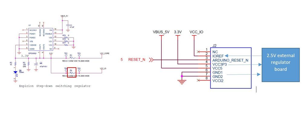

Dear, On the KIT MAX R 10 10M08 Eval Kit Board is it possible change the voltage of the regulator EP5388QI from 3.3V to 2.5V? The VCC_CORE can be 2.5V for the proper operation? I not using the Arduino or Opamps circuits from this board.

    1.2 V volt is the the core voltage on MAX10 EVAL KIT.
    What exactly you are trying to do explain with respect to the schematic please.
    About which regulator you are talking about ? I can't tell exactly which features of max 10 will get impact if you change the voltages.
    Check pin connection guiltiness.
    However we can get required voltage (0.603V to VIN-0.5V) from regulator using external divider, check datasheet for the requirements.

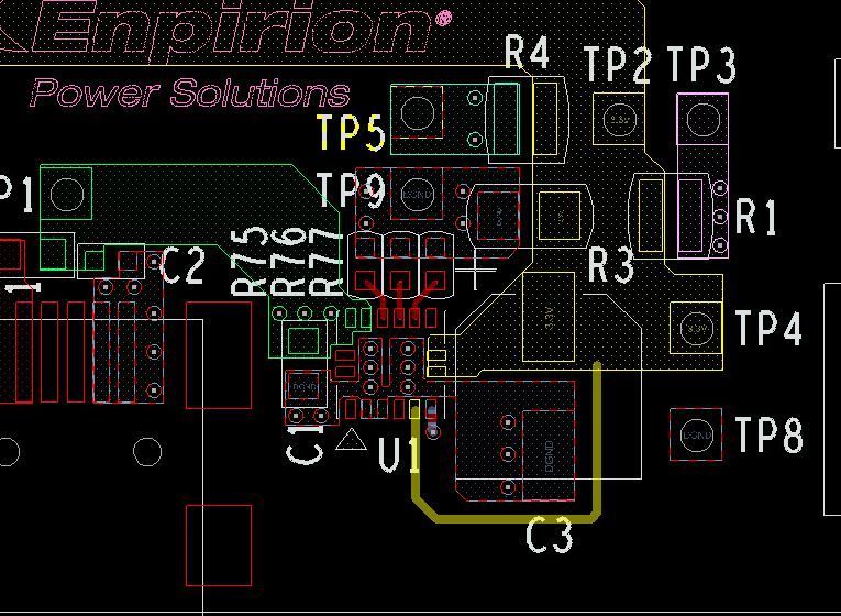

      In this response it is stated that, "1.2 V volt is the the core voltage on MAX10 EVAL KIT." However, the schematic shows that U1 is configured for 3.3V (schematic document number 150-0991402A1 dated 09/11/2014, version 1.0). This supplies both VCC_CORE and VCC_IO. I request clarification because my design requirement me to bypass the regulator and supply only 3.3V.
      A second question is if the EP5388QI will tolerate 3.3V placed on its output by an external source? VBUS_5V, normally suppled by USB, will not be present. Obviously, removing R1 and R4 while supplying 3.3V to TP3 and TP5 also looks feasible.

    Dear,
    On the schematic of the Kit there are a regulator called U1(PN> EP5388QI), on this regulator is connected VCC_CORE and VCC_IO.
    I need 2.5V on the VCCIOs but on this design of board there are just one regulator and if i change the voltage in this regulator(U1) the voltages of VCC_CORE and VCC_IO will be change together.
    What You sugest to change the voltages on VCC_IO to 2.5V on this KIT?

      ​Hi Dan,
      Okay, It depends on Output voltage select pin 10,11,&12.
      The regulator section board is designed by selecting one of seven preset output voltages here it is 3.3V, not by choose external divider.
      I don't think we can change the voltage.
      Anand

    Dear,
    I think the best way is disconnect the R4 Shunt resistor and supply the 2.5V using an external regulator connected in a J2 connector.
    At least there are a possibility to use a external board. Thank you , if You have better suggestion , please, share.
    Dan

      ​Hi Dan,
      If we remove the R4 still, we will get 3.3V only.
      Layout is designed like that. We don't have any via at R4.
      Anand

    Dear, The Idea is disconnect R4 and on TP5 side is connect the output from one external regulator with 2.5V, the bad side is to connect an external board with a regulator.
    Dan

    Dear, Just to check , the idea is remove the R4 and connect an external board regulator on the J2.
    Its possible? The FPGA partnumber used on this board said that this is a Single Supply and can work with 3.3V on core and 2.5V on VCCIOs.
    Daniel.

      ​Hi Daniel,
      Yes, We can remove the R4 and use J2.2 for external supply.
      VCCIO is not monitored by POR so we can supply it any time we required. example : We can also power up VCCIO for IO banks individually after configuration based on our design requirements.
      So, I am not seeing any problem, But however Intel will not be liable for any damage that you may occur as a result of modification, either with or without your knowledge.
      Anand
