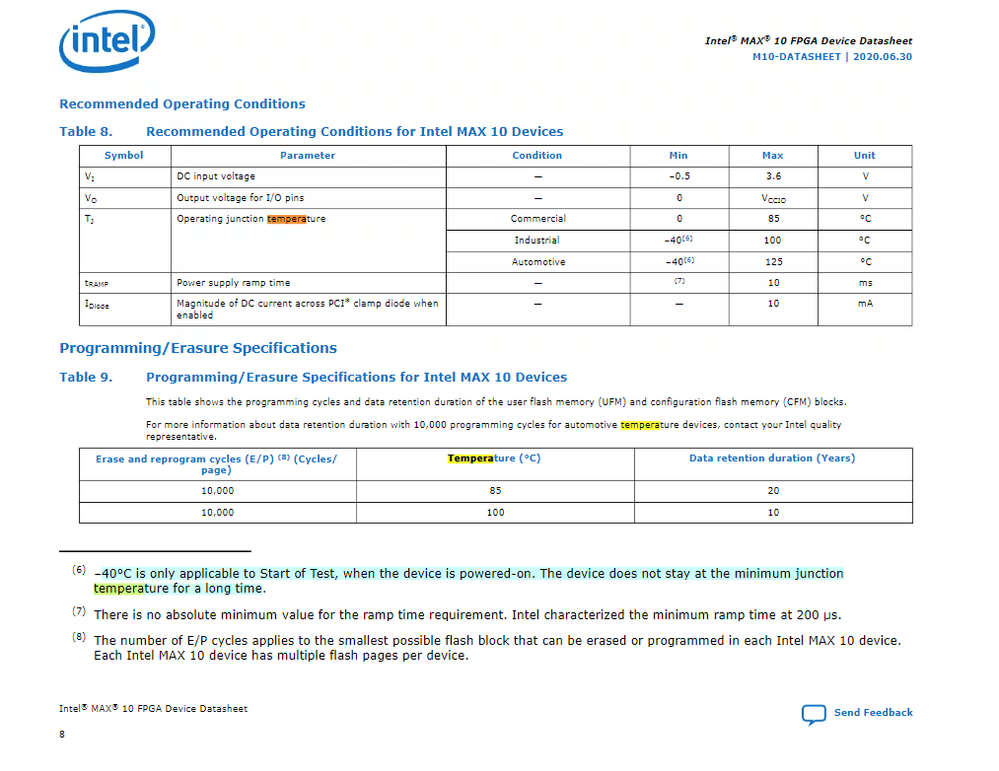

I'm from CYIENT. We are using 10M02SCE144C8G FPGA in our project. As per requirement the FPGA should sustained up to -40 °C. In the datasheet minimum junction temperature is given as -40 °C but with note:
could you tell me how long it can sustain at minimum -40 °C in operating condition.
I have attached the screenshot of the datasheet note for the reference.

We don’t guarantee how long the device can sustain at -40C. What we guarantee is the device can operate as low as junction temperature at -40c.
It is normal that when device is power on, the thermal power generated by the device will increase the junction temp.

Thank you for the response. I have checked the EPE tool but this tool will estimate my junction temperature according to logic but I want to use my device at -40 C for at least 2 hours. Could you check and tell me whether it will be an appropriate FPGA for this temperature or else can you give a list of FPGAS with similar functionality.
