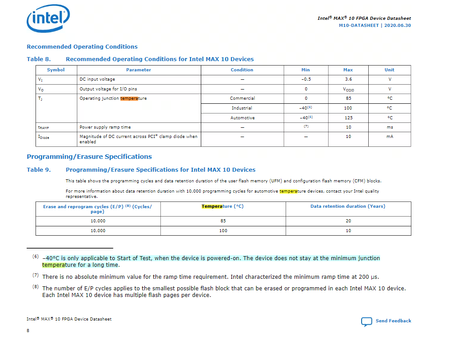

10M02SCE144C8G Maximum operating junction temperature
We don’t guarantee how long the device can sustain at -40C. What we guarantee is the device can operate as low as junction temperature at -40c.
It is normal that when device is power on, the thermal power generated by the device will increase the junction temp.
We have EPE to estimate the Core temp in the website: MAX 10 PowerPlay Early Power Estimator (EPE) | Intel
Hope that answers your question
Nazrul Naim
- Eva2Ethan2 years ago
Hello Nazrul,
Thank you for the response. I have checked the EPE tool but this tool will estimate my junction temperature according to logic but I want to use my device at -40 C for at least 2 hours. Could you check and tell me whether it will be an appropriate FPGA for this temperature or else can you give a list of FPGAS with similar functionality.
