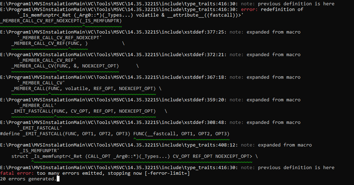

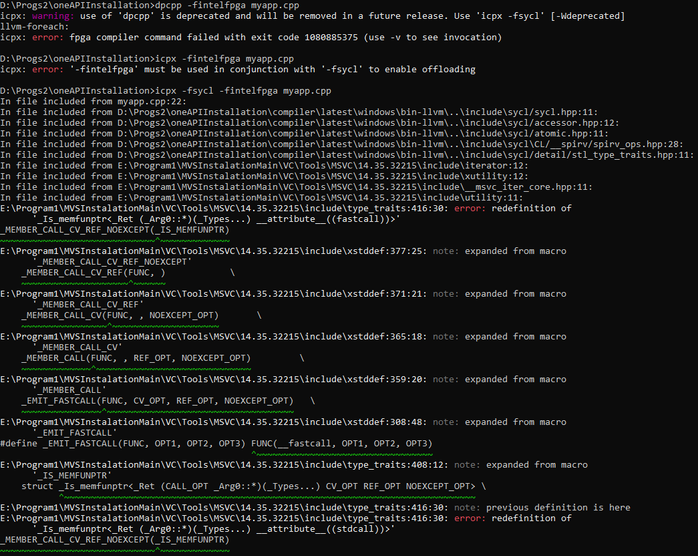

Many errors while SYCL-code compilation for FPGA on local system
I have installed on my local system (with OS Windows) oneAPI Base Toolkit. Compilation was executed in Intel oneAPI command prompt for IA32 for Visual Studio 2022.
Compilation flow was provided considered to FPGA Flow: https://www.intel.com/content/dam/develop/external/us/en/documents/oneapiprogrammingguide-8.pdf (page 32-33).
I stucked in the start of flow (with command "dpcpp -fintelfpga <source_file>.cpp"):
Source code of compiling file (oneAPI sample "vector-add-buffers.cpp"):

Compilation flow and part of output with many errors:
Part of output in the end:
