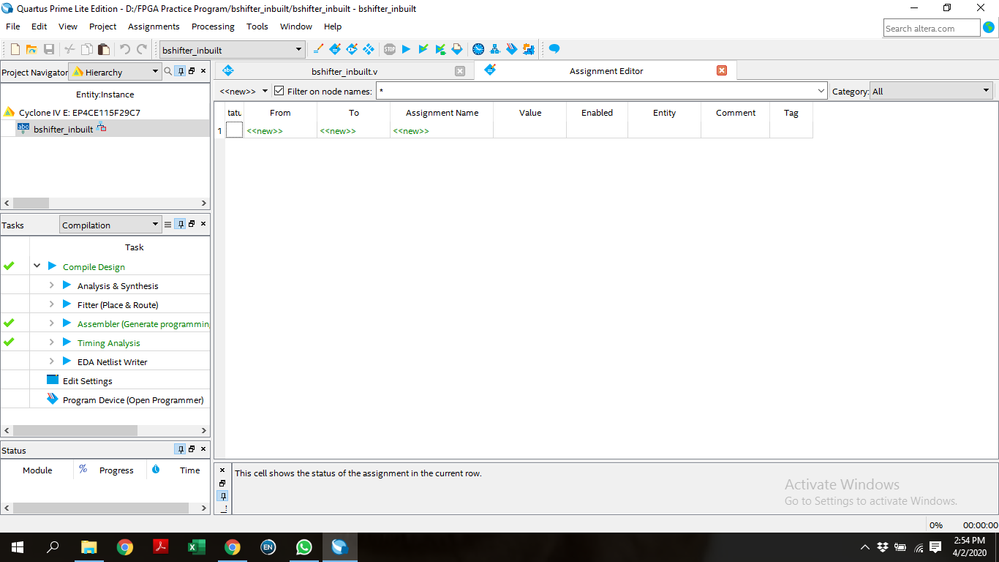

Thank you for your reply KhaiY. Could you please assist me how can I keep/preserve synthesis attribute in the Verilog language? I am a beginner in FPGA and Quartus, and I am not familiar with the basics of using it. One more thing, when I follow the path Assignment-->Assignment Editor, I am not getting 'Preserve Registers' option. I have shared the screenshot of what I can see after selecting Assignment editor. I would be grateful if you can help me out.
I am using Quartus Prime Lite Edition.
Pallavi

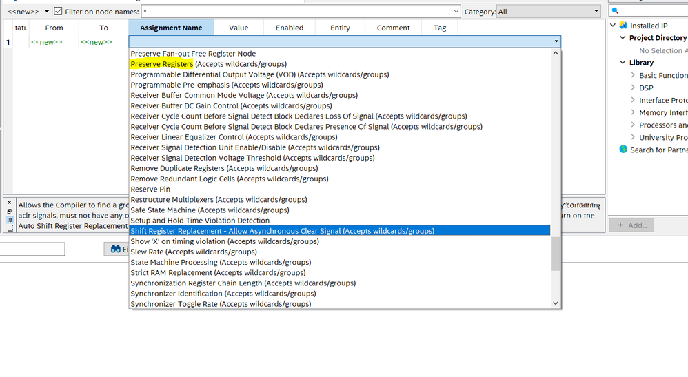

Besides this, you may find the preserve register assignment in the dropdown menu in Assignment Editor
