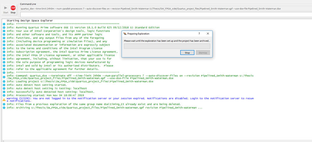

Can't run DSE II on a high performance computer.
I am connecting to a university high performance computer through Putty. The computer has Quartus 19.1 installed. After opening my project in Quartus, I launch the design space explorer. I set it up the same way I do on my local machine but when I try to run it I get the following errors:
What is causing this and how do I solve it?

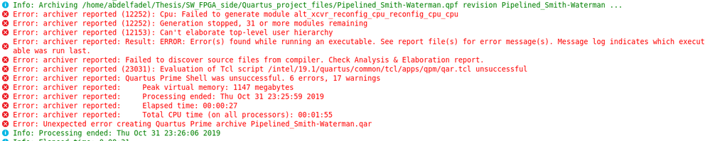

      1)Standard
      2)If you mean a standard compilation in Quartus, I just tried, it doesn't work. It also generates the "cpu: failed to generate module..." error
      3) I'm not sure what .qar files do and am not familiar with them. I have not generated one myself but I am attaching the .quar file that I found in the dse folder

      It might also be relevant to add that the project was initially created in Quartus 18.1. Also, after I open the project in Quartus 19.1 on the university computer and fail to compile there, when I reopen it again in Quartus 18.1 on my local machine and run DSE II, DSE II stays stuck setting up the compilation forever. The only way I found to fix this is restoring my project from a backup made efore I opened it in Qaurtus 19.1

      Like I mentioned before, a colleague of mine is using the computer and compiling without problems. After experimentation I now suspect that the stratix V hard IP for PCIE is causing the issue. The error message does not appear if that module is not included in the project.
