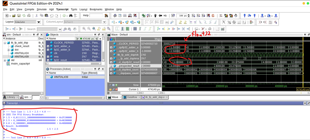

    Since you're currently unable to provide a simulation test case, I’ve created a simple test using the fp32_add function from the Native Floating Point DSP IP for Intel Agilex FPGA. The simulation was performed using Quartus 24.3 targeting an Agilex 5 device, and it appears to run successfully, as shown in the attached screenshot.
    I’ve shared the simulation folder (fp_add_dsp.zip) via email for your reference. You can review the following files to rebuild the simulation on your end:

      Just to keep you informed — I’ve tested the Native Floating Point DSP IP in MAC mode, and the simulation appears to run correctly (please ignore the last 3 signals which are irrelevant).
      Given the discrepancies in our observations, please feel free to share your simulation files that replicate the issue you're seeing. This will help me investigate further and identify any potential differences or root causes.
