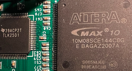

Hi, We're having some wird temperature issues with some newer 10M08SCE144C8G FPGA chips date marked with "2301A". The FPGA chips are used in an older MUX design "which have always worked before". Some of the "2301A" chips, however, does not operate as normal at 25C room temperature. However, if we apply external heating they suddenly start working as normal at arond 35-50C. Looking at some of our older circuits boards without temperature problems, with FPGA chips date marked "2007A", I cannot help notice the text painted in white color is very easy to read: Old, working FPGA. Please notice clear, white text. Compared to examining the newer "2301A" boards, the one with temperature problems, the text is almost impossible to read, like the white paint inside the text is completely missing: Newer, failed FPGA. Is the more unclear text a sign of soldering heat damage? What's the most possible explonation: 1. The FPGA has been mounted using the wrong soldering profile with to high temperature 2. Intel has simply removed the white paint from its Altera MAX 10 chips. Nothing to worry about. 3. These are fake, chineese duplicates (and yes, these boards have been assembled in China). Please advice.2.5KViews1like14Comments
