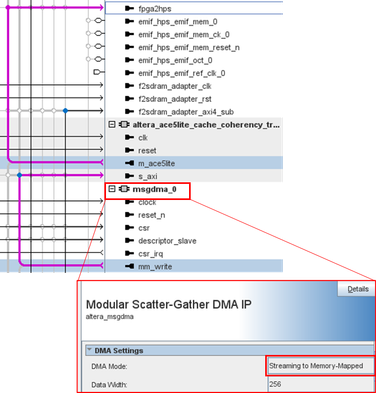

Quartus Error When No Read Path Exists on F2H Bridge
I am currently investigating a Quartus compilation error related to the FPGA-to-HPS (F2H) bridge on Agilex 5 devices.
[Environment]
  • Device: Agilex 5
  • Tool: Quartus Prime Pro v25.3
[Issue / Observed Behavior]
  • Connection configuration:
    mSGDMA (Streaming to MM) -> CCT -> F2H bridge (see attached diagram)
  • HDL generation in Platform Designer completes successfully
  • In the RTL Viewer, the F2H-related logic appears to be instantiated, and the F2SOC_RDATA signal seems to be present in the generated RTL
  • However, during Quartus Prime compilation (Synthesis phase), the following errors occur:

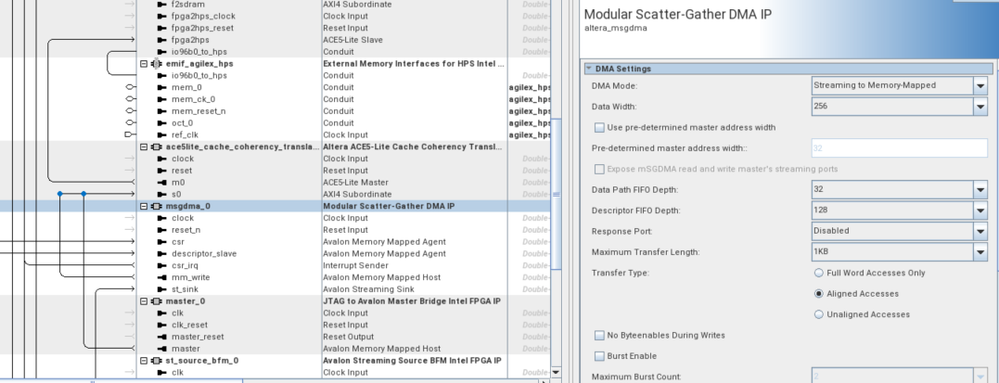

[Workarounds / Configuration Changes Tested]
To ensure that a Read path toward the F2H bridge exists, we tested the following changes:
  • Connecting the F2H bridge via a JTAG Avalon Master Bridge
  • Changing the mSGDMA DMA mode from "Streaming to MM" to "MM to MM", and connecting mm_read to the CCT
  • Enabling mSGDMA Pre-Fetching Options, and connecting descriptor_read_master / descriptor_write_master to the CCT
These changes allow a read-capable master to exist toward the F2H bridge.
[Question / Confirmation Point]
  • In a configuration where no read-capable master exists toward the F2H bridge, is it expected (by specification) that Quartus determines the F2H interface as not connected, even if the corresponding signals (e.g. F2SOC_RDATA) appear to exist in the RTL?
  • Even if the design logically requires write-only accesses, is a valid read path master still mandatory for the fpga2hps interface to be considered legally connected?
Thank you in advance for any clarification.
  • I was able to reproduce this error internally. Indeed, the F2H bridge expected the "READ" part to be enabled. I'd say you can satisfy this by just adding a "avalon" device (like the JTAG master) to the CCT, in this way you can keep "Streaming to MM" if you wish....
  • EstebanVV_Altera's avatar
    EstebanVV_Altera
  • s-harada's avatar
    s-harada
    Thank you very much for checking this and reproducing the issue internally.
    As you explained, I understand that the F2H bridge expects the READ part to be enabled by specification.
    Even if the actual data transfer in the design is write-only, the absence of a logically valid READ path would result in this error, which is the expected behavior.
    Thank you for the clear explanation and confirmation.
