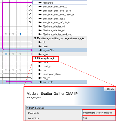

Hello, I am currently investigating a Quartus compilation error related to the FPGA-to-HPS (F2H) bridge on Agilex 5 devices. [Environment] Device: Agilex 5 Tool: Quartus Prime Pro v25.3 [Issue...

I was able to reproduce this error internally. Indeed, the F2H bridge expected the "READ" part to be enabled. I'd say you can satisfy this by just adding a "avalon" device (like the JTAG master) to the CCT, in this way you can keep "Streaming to MM" if you wish....
