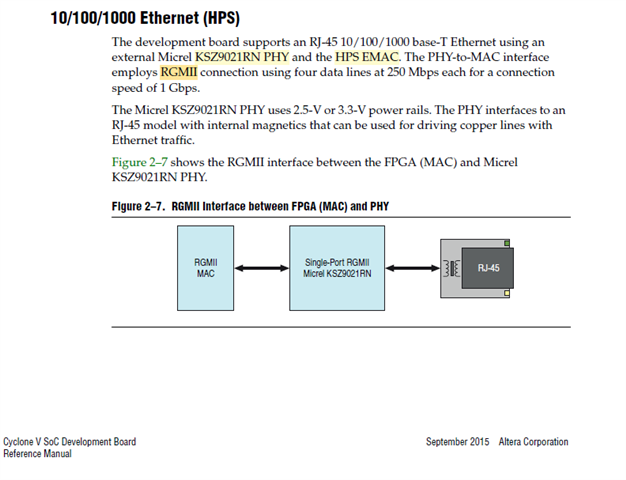

I have tried a lot of other things. For example I tried to enable gmac1 and disable gmac0 or disable both but without success. I had seen the approach with the own .conf and the .overlay file several times (e.g. for a STM32). So I think my approach is correct, but no network interface is recognized (Ethernent). I hope that someone sees my mistake and can help me. I would be very grateful for that. Finally, I'll insert a small screenshot from the documentation showing which Ethernet interface I'm using:

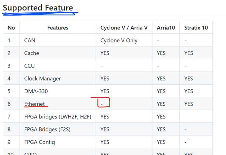

      And in the git-repo there is the folling Table:
      Therefore i got errors, that the "properties" phy-mode isn't define, so have to do the following:
      --> in ...\zephyrproject\zephyr\dts\bindings\ethernet\snps,ethernet-cyclonev.yaml
      --> i had to add the property phy-mode myself
      --> so what is the message that the devoloper of this code wanna say me? I dont need an overlay-file? or i dont need to mention phy-mode and mdio? But it doesn't work eithter...
