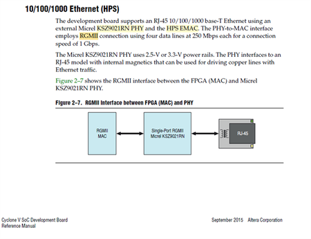

Hello everyone, I have zepyhr running on the Cyclone V according to the following instructions: https://docs.nordicsemi.com/bundle/ncs-2.5.2/page/zephyr/boards/arm/cyclonev_socdk/doc/index.html Nex...

It seems like the GMAC Driver in the repo is not compatible with the Zephyr.
From the repo it seems like the net4 example is not supported for the CycloneV.
