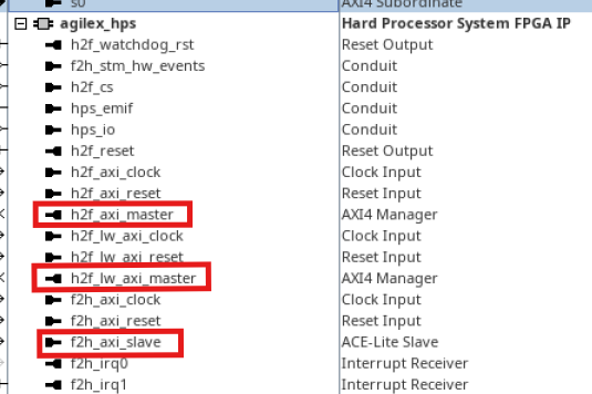

By default, GHRD enables all HPS bridges.
You can find more information for the HPS Parameters for bridges here:
https://www.intel.com/content/www/us/en/docs/programmable/683581/current/hps-fpga-axi-bridges.html
You also can check where the bridges connected to via the Agilex HPS IP.
Tracing down to h2f_lw_axi_master, the address offset for the pipeline bridge is 0x1000.
Through the pipeline bridge, the PIO IP (led_pio) that controls LEDs has address offset of 0x80.
0xF9000000 + 0x1000 + 0x80 = 0xF9001080
