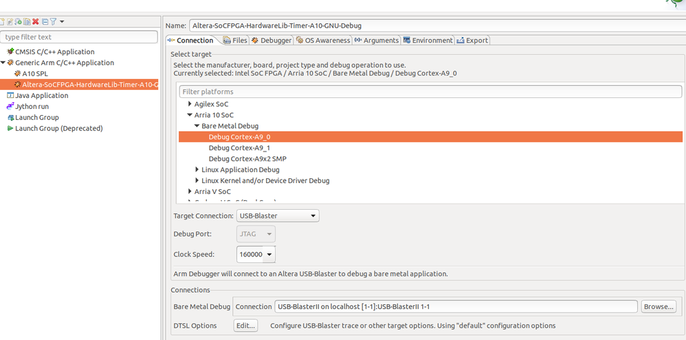

after i imported the Altera-SoCFPGA-HardwareLib-Timer-A10-GNU.tar.gz into my workspace and completed the debugger setting as below:

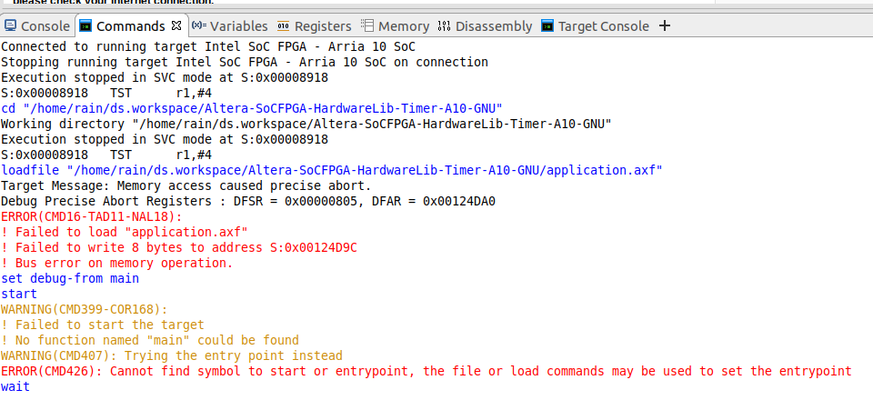

after i click on Debug to start a debugging session, The debugger didn't download the sample application executable on the board, and didn't run it up to the
main
function.
then i checked the commands window and found below errors
I searched these error on internet but found nothing usful for me. please give me your comments for this, thank you in advance.
  • i found the root cause, the error is caused by the too early exit of uboot spl debugger bufore excecuting the app.
    now i understand the app depends on the hardware initialization by the uboot spl.
    so after successful running uboot spl, i disconnected the target and run the app examples immediately and it also succeed.

    • Rainwang's avatar
      Rainwang
      pls see my solution, you need to run the uboot spl firstly then switch to app, because the app depens on spl to initialize the environment.
