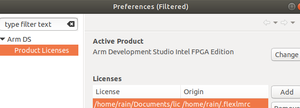

Welcome to INTEL forum. To narrow down this issue, can you please provide me the latest of the following?
1) Debug.log file
2) license.dat file
You can also reply/attach your file in private message.
Considering the private license information, I had sent you these files via mail. I am not sure if you can get them.
For the debug.log you mentioned, I have not found it in arm directories, so I just copy the information which appeared on the console/commands/target console windows of the arm DS into a file for your reference.
If you told me where to find the debug.log, I will copy it to you then.
