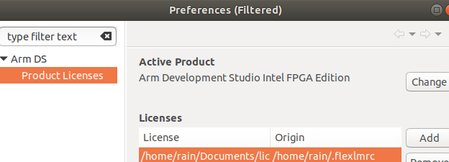

hi, i faced another error. My PC environment: virtual box 6.1 + Ubuntu18.04 on windows 10, Quartus pro 20.1 linux version + SOC EDS pro 20.1 linux version + Arm development studio 2022.0 li...
