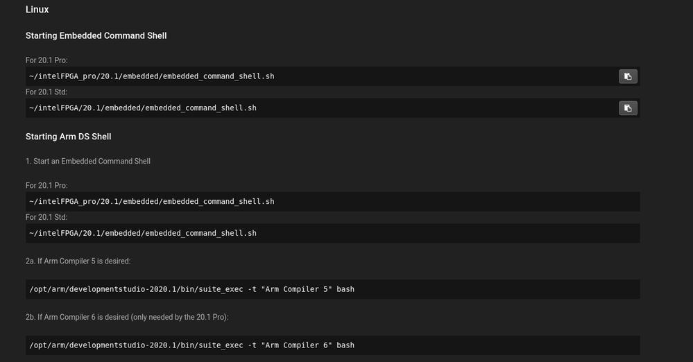

    2.How can I resolve it to ensure that the SoC EDS functions correctly?
    Could you check if you are following the steps for SoC EDS according to the link below:
    https://www.rocketboards.org/foswiki/Documentation/SoCEDS#Starting_Embedded_Command_Sh_AN1

      I have been following the quide for installing SoC EDS and Arm DS-5. But while executing the command embedded_command_shell.sh i'm getting the following error WARNING: DS-5 install not detected. SoC EDS may not function correctly without a DS-5 install.
      I am using Intel FPGA Pro 20.1 and SoCED 20.1.

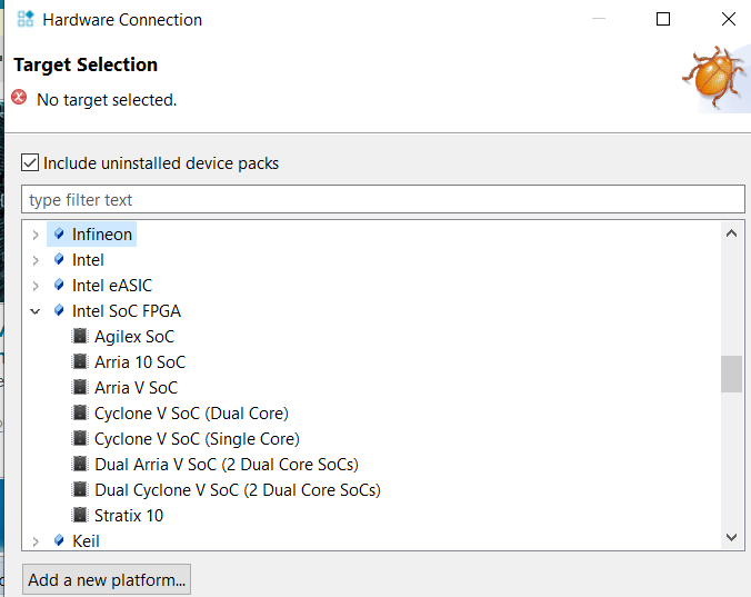

    A little history on the SOCED. In previous release of the SOCED the eclipse installation was added together with the SOCED installation.
    On 20.1 the eclipse installation was separated from he SOCED installation. That is why in 20.1 there are separate steps for ArmDS installation.
    Yeah you could use the ArmDS without installing the SOCED. You are able to see the Intel Device under the device selection.
    Jingyang, Teh
