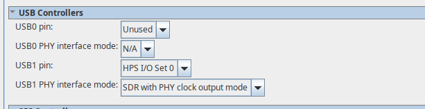

I'm a bit confused about your request on USB0 configuration. The HPS only enables USB1 and that is why I think USB0 is just disabled. This is from the HPS peripheral configuration page:
I've found identical setups on other Cyclone-V based projects, so I assumed that should be okey.

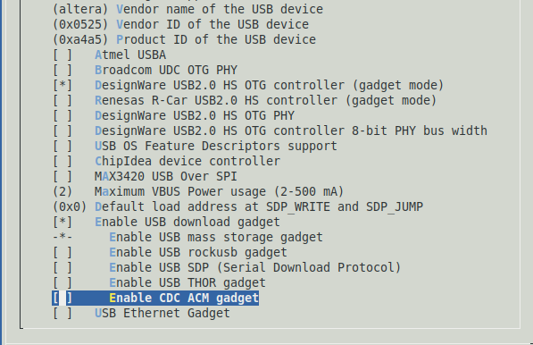

My feeling is that maybe there is something missing in the u-boot config, but I'm not able to find what it might be. I understand ULPI drivers/handling should work out of the box? This is my USB configuration:
Could I be missing something?
