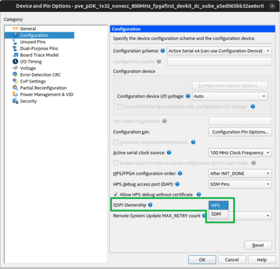

  • Hi Eric
    In 25.1 a new feature was introduced to control if you want to allow or prevent to grant the ownership of the QSPI to the HPS.
    https://cdrdv2-public.intel.com/853092/ug-813762-853092.pdf
    See section 4.2.1 and 4.12.
    Check in your hardware design if the QSPI ownership is assigned to the HPS. If this is not the case, then the SDM will reject the MBOX_QSPI_DIRECT mailbox.
    Rolando

  • RolandoS_Altera's avatar
    RolandoS_Altera
    Hi Eric
    Rolando
  • EricOpitz's avatar
    EricOpitz
    Hi Rolando,
    This solves the problem. Thank you for your Help!
    Kind Regards,
    Eric Opitz
