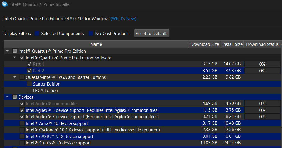

May I know how you installed Quartus?
I recommend using the installer and making sure both the Agilex 5 and Agilex 7 devices options are selected.

- RichardT_altera
To get the .qdz file, go to the Download Center webpage for the respective Quartus version. Then click the "Individual Files" tab - which is beside the 'Installer (Recommended)' tab, and then scroll down the page to find the respective device .qdz file.
