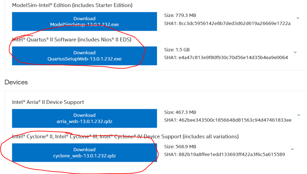

        it should be possible to reset licensing mode of Quartus 7 Web Edition to free license, but I'm not sure how to. I remember that old Quartus Web Edition from time to time comes up with a message that license has expired. Refreshing the license isn't supported because the respective server doesn't exist since many years. One possible choice in the dialog is "Evaluation Mode" which must not be selected. I was always able to skip the dialog and operate the old software as before, but I don't know if there's an official solution.
        The latest Web Edition supporting Cyclone and Cyclone II is 13.0.1, still available for download. In case of doubt, I'd try to install this version.
  • FvM's avatar
    FvM
    you are confusing versions. 13.0.1 is 13.0sp1, you are showing device support info of 13.1
    You minimally need two installation files from "Individual Files" tab, QuartusSetupWeb-13.0.1.232.exe 1.5 GB and cyclone_web-13.0.1.232.qdz, 569 MB.
    Frank
    • _AK6DN_'s avatar
      _AK6DN_
      As an FYI, I have a TerAsic DE1 board with the CycloneII device and I use Quartus Web 13.0sp1 to compile code for the board.
      It works just fine. I have used it on XP and Win7 and now Win10; have not tried Win11.
      So 13.0sp1 is the way to go forward.
