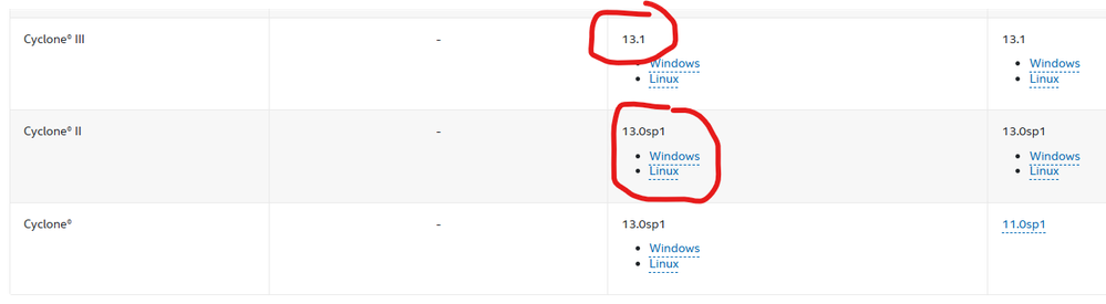

I did research to check weather cyclone II is supported by the latest Quartus version.
Referring to the screen shot, Quartus II 13.0.1 only start to support Cyclone III and above.

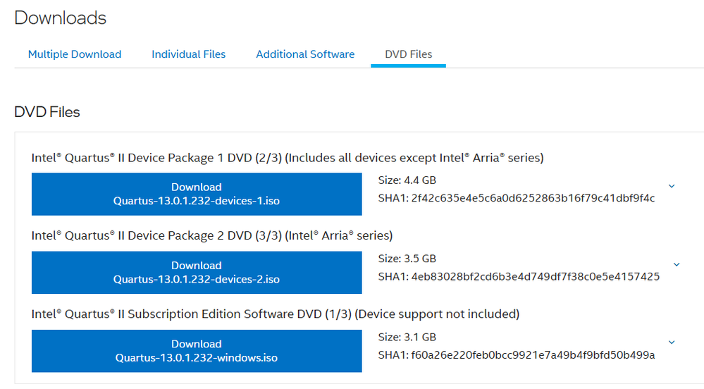

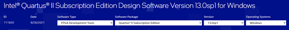

For Cyclone II, I need to install Quartus II 13.0sp1. Do this version needs a paid license?This QII version also have 3 disk? Should I download all version?
Please kindly advice.
Thank you.
