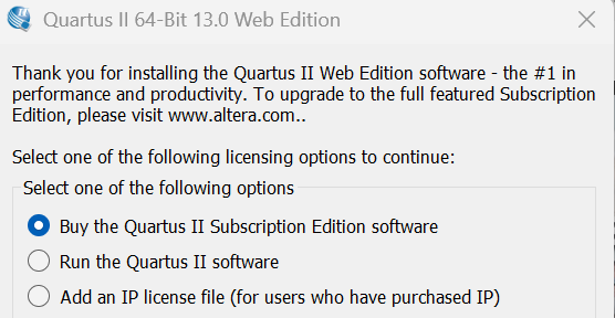

- _AK6DN_1 year ago
No, the web version of Quartus 13.0sp1 does not require a license. Just install and run. It supports the DE1 board directly.

Hi.
I get the message when I open the QII.
Would I face the same issue where the .sof file is not generated after compilation because of the web version?
Thank you.
S_Dyn.
