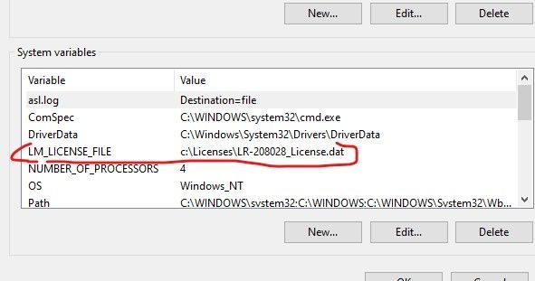

For completeness, here is a shot of the Windows environment variable dialog box:
I've got to be doing something wrong, but what?
