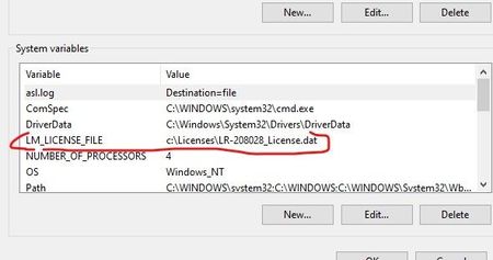

1 year agovsim Can't find license file for Questa*-Intel® FPGA Starter Edition SW-QUESTA
I have downloaded and installed Questa*-Intel® FPGA Starter Edition SW-QUESTA, requested a license for same from the portal, received this by email and installed it (on a Windows box). When I try t...
- 1 year ago
Hey Frank,
Thanks for picking up this thread.
Tried the SALT variable to no avail. However, removing conflicts between system and user variables (result of earlier experiments when I had the dud license file) , a reboot and a nice hot cup of tea seems to have fixed it just now!
Thanks again.
FvM
1 year agoHi,
under circumstances, Questa works only with SALT_LICENSE_SERVER entry, as reported several times in this forum. It's depending e.g. on other Software installed on your computer.
Suggest to try.
Frank
