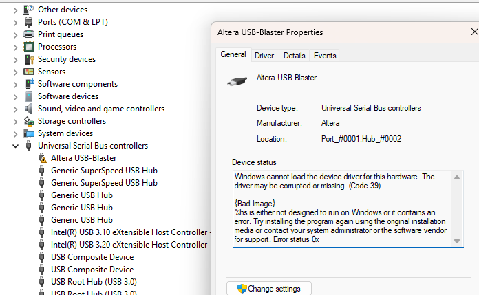

Device Manager Error reporting when USB blaster is connected. Signal Tap doesn't recognize any hardware connected.

    OP is asking about USB Blaster rather than USB Blaster II. Driver and installation procedure are quite different for both products.
    There may be a problem if you still have an old, not Windows 11 compatible FTDI driver stack on your computer. Did you try to remove USB Blaster completely in Device Manager, enabling delete driver software option?
