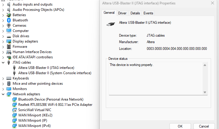

We are using MAXV and Quartus Prime Lite Edition. We purchased a USB-Blaser II. We are able to program the device, however in between "sessions" when we plug in the USB it sometimes fails to recognize the MAX Device. It does see the JTAG cable, but when it is NOT seeing the device we notice in hardware setup the JTAG frequency is not selectable. After much trial and error we find that we must go into device manager and "uninstall device" and then unplug/plug in the cable to get it to work. However even this isn't always repeatable and we sometimes need to do this multiple times. We know it is going to work when the JTAG frequency is displayed as 24000000 in hardware setup, otherwise it is blank and un-editable. Why is this so unreliable? We believe the right drivers are installed as it is the latest download, and when it work, it works good.

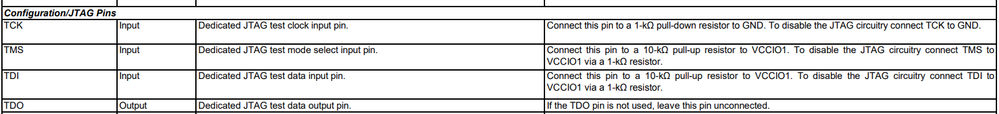

    4- Could you screenshot the JTAG part schematic? Double check the JTAG pin connection is correct.
    MAX® V Device Family Pin Connection Guidelines

      -- This is our first time using the tools. The first time we plugged it in it worked fine. Seems like the problem occurs after unplug / plug the USB cable, even if quartus is shut down. I never has worked "well", once it works it is fine and repeatable. Once it stops working then I go through the procedure described above:
      "go into device manager and "uninstall device" and then unplug/plug in the cable to get it to work"

    2- From the schematic, The JTAG header pin order looks fine. But I can not see whether there's pull-up or pull-down resistors. Please check from the schematic for the JTAG pins and confirm:
    -- Connect TCK pin to a 1-kΩ pull-down resistor to GND.
    -- Connect TMS pin to a 10-kΩ pull-up resistor to VCCIO1.
    -- Connect TDI pin to a 10-kΩ pull-up resistor to VCCIO1.
    If these pull-up/pull-down are not correctly connected, then the JTAG state machine in MAX V might fall into in a wrong state.
    3- Also, sometimes this also happens if the JTAG header has some soldering issues or the cable are not well connected. Although the possibility is low that this happens to two boards.
