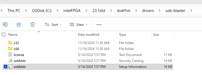

The drivers that come with Quartus 23.1 installed OK for me on Win 11. When you go looking for drivers on the internet, the links I found pointed to outdated drivers that resulted in errors and unsigned certificates. When I updated the drivers for Altera USB-Blaster in the Device Manager (under USB Controllers), I navigated to the ones in the IntelFPGA directory. These are the newest ones that do not appear to be available searching on the internet.
