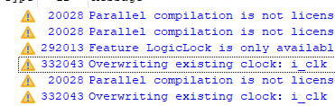

I solved the problem by creating a manual.out.sdc file with input/output delay set to 0 using TimeQuest Timing Analyze.
However, 332043 Overwriting existing clock: error has been added. How should this be resolved?
Thank you.
- sstrell
You now have two .sdc files? Why? Combine them.
And I/O delays should not be 0 in a .sdc.
- TingJiangT_Intel
Contributor
Hi there, please check if there has some conflict constraint on this first, or if the overwriting is a right sdc you can ignore the warning.
As the previous reply, you'd better combine this two sdc file to ensure there is no conflict.
