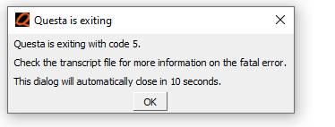

I tried to follow the given solution, but it makes Questa sim crash. Moreover, it seems the -novopt option is deprecated.
If I remove the "-suppress 12110" option, Questa sim does not crash but reports this error, thus simulation is also not possible.

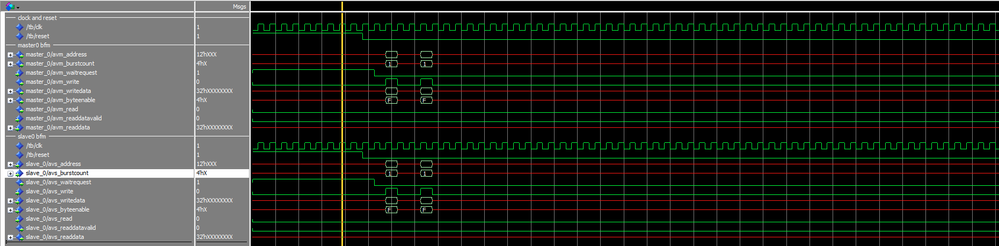

I had used the Quartus® Prime Standard Edition Design Software Version 23.1 with Questa Starter Edition 23.3 and tested on the example design avlmm-1x1-vhdl without any problem check attached log file and waveform.

Quartus is standard edition 23.1 and questa is 23.3 Fpga edition (not starter).
Here is result of the example design without the workaround.
It does not crash and works with the workaround.
