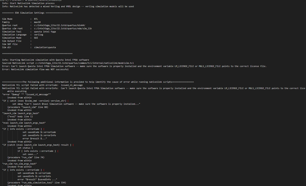

I am trying to run a questa simulation on quartus prime 22.1, but keep on getting a license error. This is the nativelink rpt screenshot:

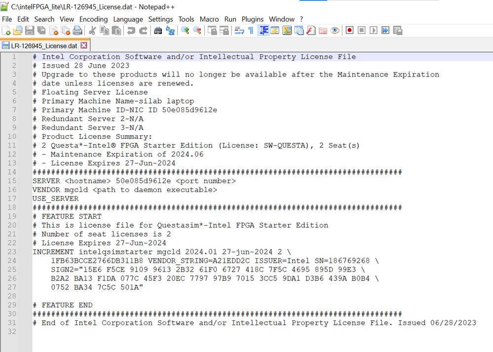

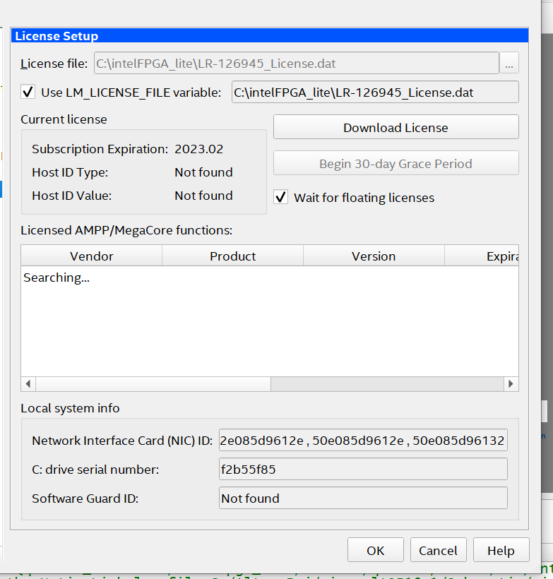

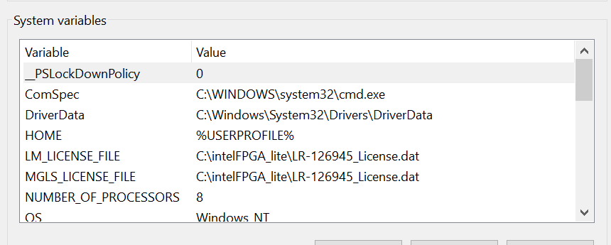

which is weird since i already specified my license file path:

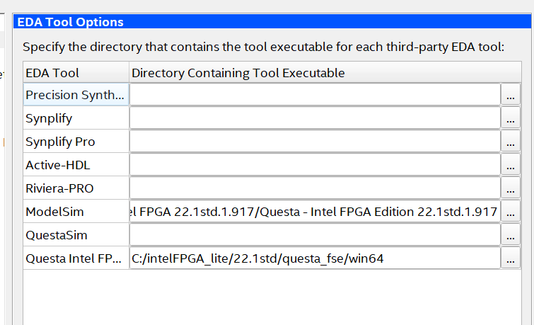

and the path to questa in my quartus software:

    I messed around abit and realised the issue is due to the program not being able to find the msvcr120.dll extension. However it is already installed in my computer, im not sure how to point the software to the extension path

    Also it looks like you have a floating license but you're using it as a fixed local license instead of pointing to a license server.
