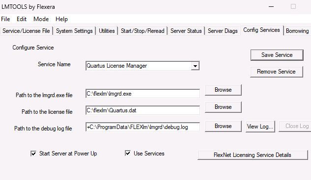

    Ok, so i installed flex license manager and the siemens one.
    I configured the license service using the lmtools within the flexlm install. Configured as follows
    Then before starting the service i edited the license file like this
    SERVER ServerName MacAddress 1800
    VENDOR alterad "C:\flexlm\alterad.exe" PORT=1801
    VENDOR saltd "C:\Program Files\Siemens\License Server\saltd.exe" PORT=1802
    Surely that is all that is needed?
