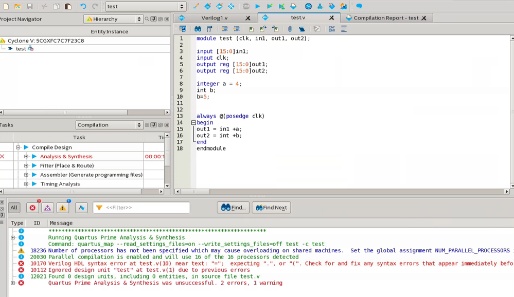

  • KhaiChein_Y_Intel's avatar
    KhaiChein_Y_Intel
    I cannot reproduce the error in your previous reply. Using int in the verilog file caused a syntax error. Could you provide the qar file for investigation?
    KhaiY
    • AKhan88's avatar
      AKhan88
      It's against my company policy to do so. Apologies for that.
      If you really want to recreate it. Try doing what i did in the question i asked above. That function is inside a package and is imported within a module. Try compiling it in Quartus that way.
    KhaiChein_Y_Intel
    I try to use int in the verilog HDL and the software issues a syntax error message. Could you provide a simple test case that can reproduce the error?
