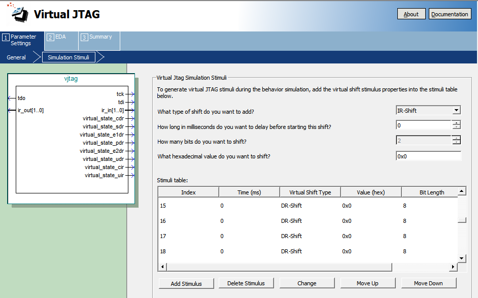

I want to simulate the Virtual JTAG IP Core, and I've already inputted several simulation stimuli that I'd like to test in the IP Parameter Editor:
From here, what do I need to do so that I can see the IP core processing these stimuli? I've tried instantiating the IP in a testbench module and moving time forward to see if something happens, but I don't see any thing happening:

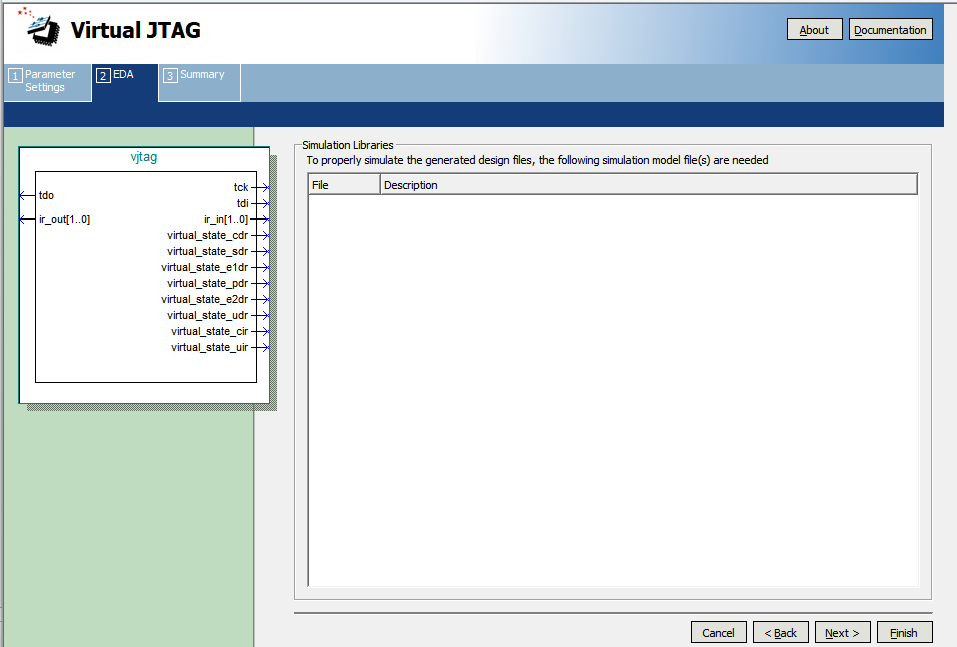

In the EDA section of the Parameter Editor, it's supposed to show any simulation model files that are needed to simulate the design, but this list is empty:

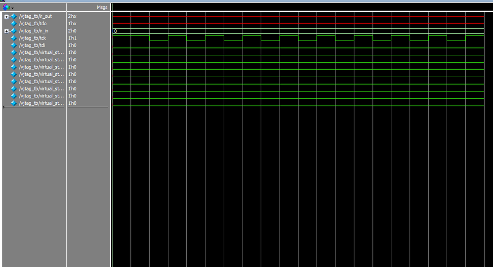

You may check the design example in this document https://cdrdv2-public.intel.com/666577/ug_virtualjtag-683705-666577.pdf (page 27). Attached the modified code, waveform for your reference.
