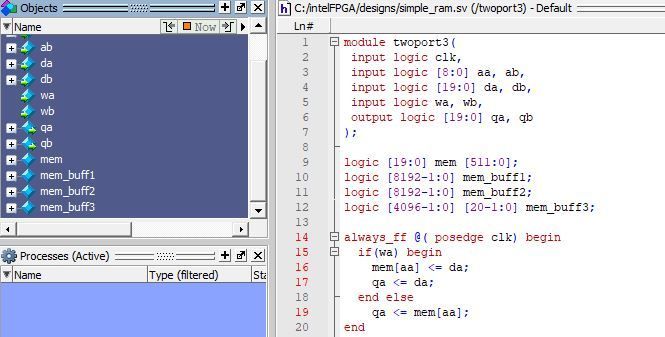

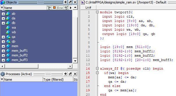

I just tried the same with a simple RAM model and I'm able to view all the mem_buffs in the object browser. Take a look at the screenshot
Same with mem_buff3 size 4096x20
- Vicky1
Can you share the project file or row_buffering_tb.sv file, if possible?
