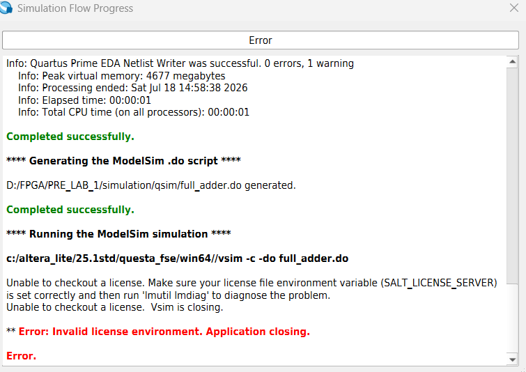

I am unable to do simulation in Quartus because of some License problem. I tried getting the certificate from the SSLC and changed the environment variables also but still i am getting the same error. Can anyone help me out where I could have gone wrong.

    May I know do you use fixed license? Please set the license path to the environment variable SALT_LICENSE_SERVER

      I had to get a no fee license from the altera  SSLC website and they send you the license to your mail and the procedure to setup the license.
