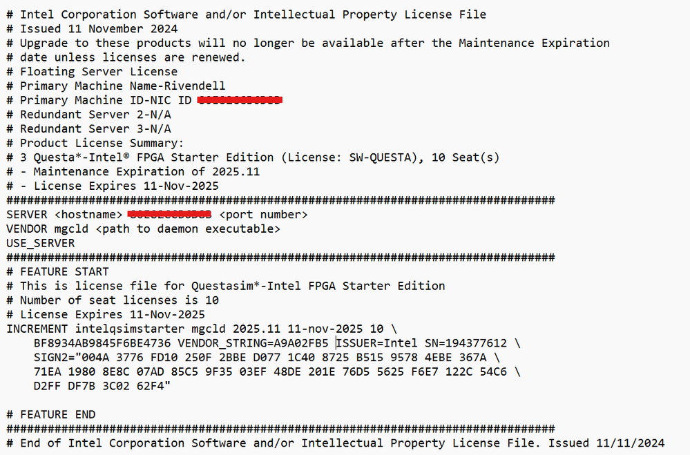

Tried to generate a floating license for Questa but looks like hostname and port id fields are empty in the license. I am trying to connect to this PC using Remote Desktop Connection.
Is there anything I am missing?

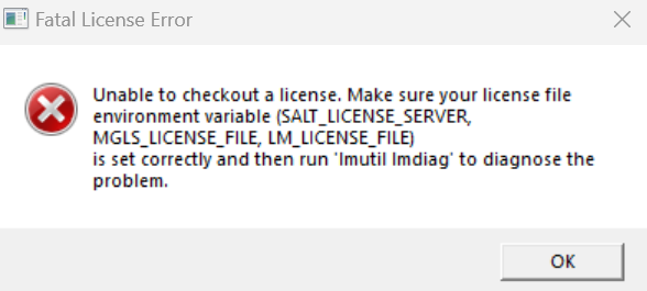

The LM_LICENSE_FILE env variable is set, but I still get the following error when trying to open Questa. Any help appreciated!

Hostname and port ID is required to make sure the floating license is working. Can you re-generate the license again? link : https://www.intel.com/content/www/us/en/support/programmable/licensing/support-center.html#license-generation
regards,
Farabi
