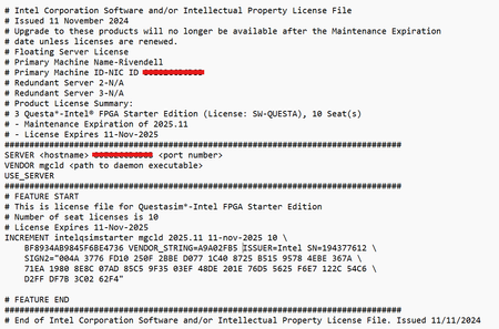

1 year agoQuesta Floating License Error
Tried to generate a floating license for Questa but looks like hostname and port id fields are empty in the license. I am trying to connect to this PC using Remote Desktop Connection. Is there...

1 year agoHello,
Hostname and port ID is required to make sure the floating license is working. Can you re-generate the license again? link : https://www.intel.com/content/www/us/en/support/programmable/licensing/support-center.html#license-generation
