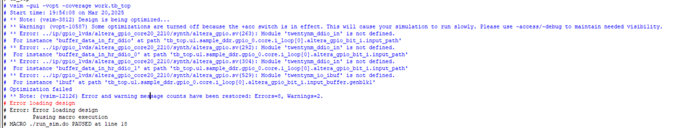

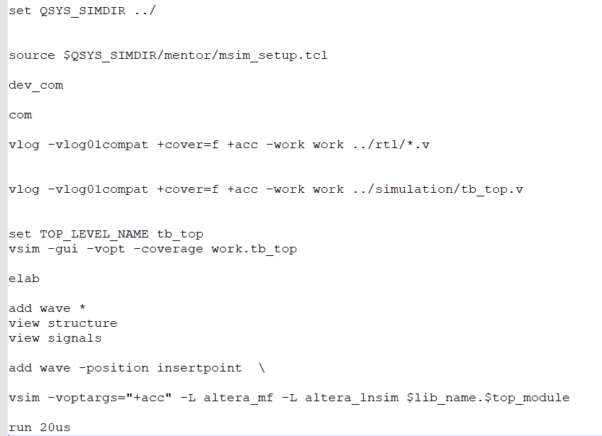

I encountered an error while using QUESTA 2024.1 for IP simulation, and I would like to know where the issue lies. Below are the steps I took:
1. generate simulator script set up for ip
2. Writing a *.do file within the document path.
3. Running a *.do file in Questa.
4. The following error warnings appeared:
By the way, while I was compiling the simulation library, the following errors also occurred:

I believe there is a missing steps in your design. Can you follow the steps in https://www.intel.com/content/www/us/en/docs/programmable/691278/21-3/prerequisites.html and let me know if does not work?
I have tested this example design and it works.
