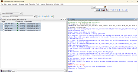

Query regarding NCO IP supportable by Agilex 7
Hi Vandhana,
Apologies for the delay.
The NCO IP isn't supported in for Agilex devices. May I know what device you choose while generating design for NCO IP?
And kindly let us know the Quartus version you're working with? The error you're seeing in Questasim has high chance due to device incompatibility.
Pavee
- FvM1 year ago
at first sight there are no obvious reasons why NCO IP shouldn't work for Agilex 7. The fact that it apparently compiles correctly in hardware Design seems to verify. Last IP Version was released before Agilex, but there are no hardware specific resources utilized. Embedded RAM and DSP blocks are quite similar to supported Stratix 10 series.
There may be an Agilex specific problem with missing simulation support. To me the reported error looks more like missing generation of simulation models, not necessarily Agilex specific. You might check to generate simulation for Stratix 10. Or perform a hardware test with Signaltap on Agilex target system.
