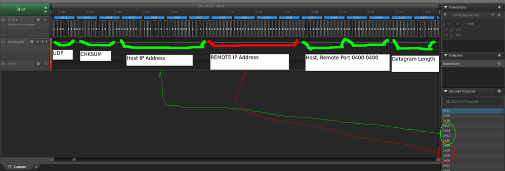

Compile code where snip is, resulted in wrong synthesis, signal was forever filled with wrong value "00" on two code part: Send REMOTE MAC, Send Remote IP.
Changing if elsif to case on MAC part removed issue to IPAddress too.
Changing from case to if elsif was deterministic :
if elsif elsif : fault .
case: working.
clean project don't affect behavior, so after cleaning same scenario.
Compile on Quartus II version 15.0 resulted in good synthesis on both version.
ANd now nightmare again.... Returning to quartus II version 18.1 upgraded again project cleaned up and wizz of havoc... generated file where ok.....
During debug some more issue appeared somewhere on other working IP core, clean project removed, final version now is working...
Saved all revision but again not able to replicate, I am suspecting some pattern sensitivity to large commented code block and when source file exceed 1K lines.
Difference was commenting if elsif or case as is here, case version .
Actually is build as shown with case commented out.
Test in progress to isolate fault, need full project, cannot replicate on small chunk.

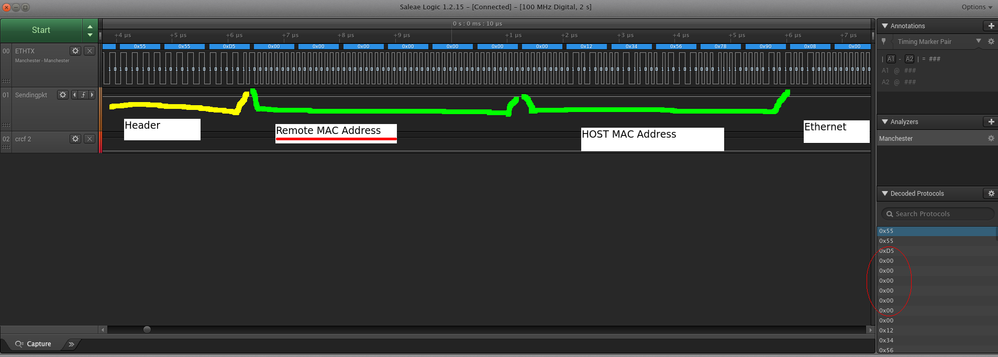

Here saleae LA decoded Ethernet frame:
**** If ELSIF ELSIF
Wrong MAC address set to zero
Wrong IP address set to zero.

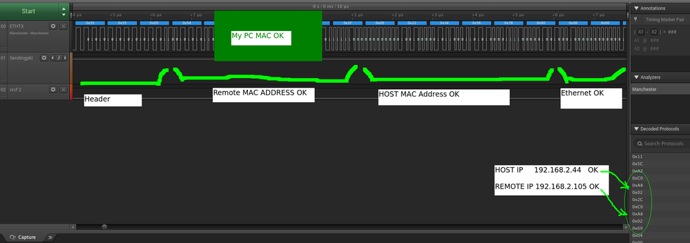

**** CASE selector on 18.1 ****
after 15.0 successful build code was reverted as shown on snippet and worked till now never touched.
