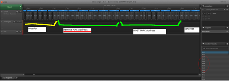

Now just injected Ethernet controller IP Core with uCless avalon controller deiven fro mUDP datagram. On Monday I start L.A and network inspection of both ram and register in Real Time try pinpoint what fail.
