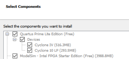

I have Quartus Lite 18.1 installed on my computer. The board I'm gonna use is DE2-115. As you can see from the image below I have already installed device files for Cyclone IV devices:

    • Interpara's avatar
      Interpara
      There's no re-install option on Device Installer tool. I uninstalled that specific device using Quartus uninstaller. After that, I downloaded Cyclone IV device again using Device Installer. It didn't work, sadly.
